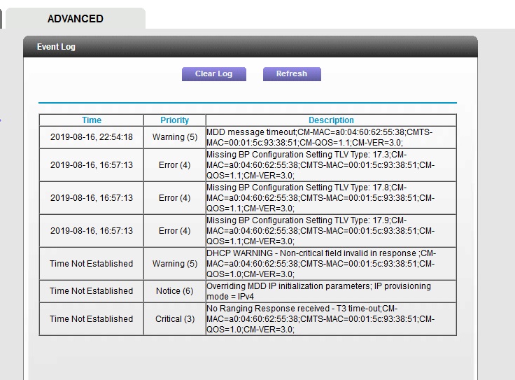

CM600 lost speed after replacing decrepit old ubee modem ?? spectrum internet
Hi folks--hoping I may get some response--this is stumping me.  Excited to have a pretty new CM600 and retiring the old Ubee from Spectrum--kept having drops on a regular basis.   Called Spectrum and got them to update the new modem, got online just fine--but speeds have dropped like crazy--rechecked with the modem hooked to my pc only, and still the 30-40 mps--the modem itself has little I can change in the settings--any ideas?  Trying to post log below--thank you

    well from your connection page, you're line has issues would be my guess. You have strengths from 3dbmv to -17 dbmv on your downloads. Thats not good. You should be within a couple dbmv range for all of them. ideal range is roughly 8 to -8 dbmv. Most all of your channels are good except for channels 2,3, and kind of 4.  I'd have spectrum check your line for issues. Also try removing any splitter, bad connectors, amplifiers, or any other devices that are in your coax line that could be causing issues

      Thank you!   So all that looks normal except for the line issues?   I'm having problems understanding why the other modem ran things faster if the line is the problem.  My apologies, not dissing your help--but why would the old ubee run better?   Are the newer modems more sensitive?   I have figured out that I dern well better get some cat 7 cable and get under the house with it.  Thanks much plemans!   hope you have a good weekend.
