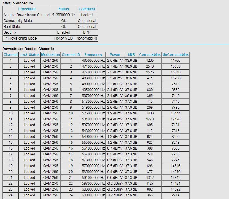

I'm using Tomato on my R7000 router. I was using Mullvad as the VPN, got tired of the slow speeds so stopped using the VPN for a while. Then my CM700 cable modem started to lose connection all the ti...

You do have low levels on the down stream you want to be between -7 and 7 and some are as low as -16 you may want to have a tech come out and look at your lines.

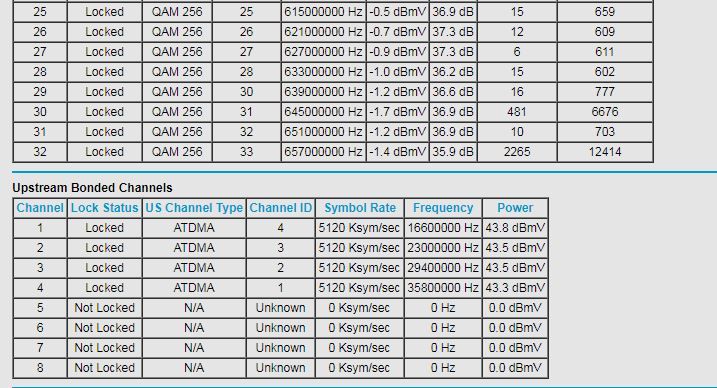

DarrenM, Thanks for looking at my post and log. Comcast just left and below is my new log. The tech said the line was all chewed by the squirrels and it fell apart in his hands. He said he installed it so now the squirrels have to hold on to it to chew it, not be able to sit on it to chew it (or something like that). He was a really nice guy! He replaced the line from the pole to my house, checked all the line around my house and gave me a no line from the tap outside to my modem (hope he didn't charge me for that).
