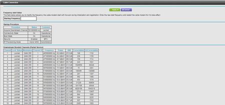

I'm using Tomato on my R7000 router. I was using Mullvad as the VPN, got tired of the slow speeds so stopped using the VPN for a while. Then my CM700 cable modem started to lose connection all the ti...

You do have low levels on the down stream you want to be between -7 and 7 and some are as low as -16 you may want to have a tech come out and look at your lines.

I've told Comcast / Xfinity that several times about my lines being bad! They are the worst.
