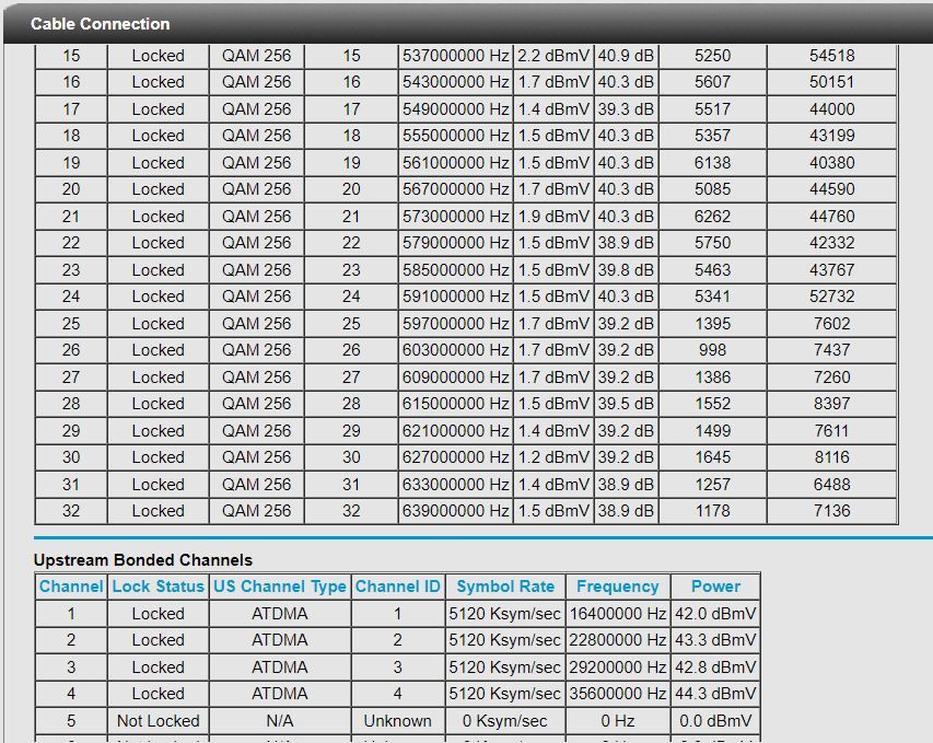

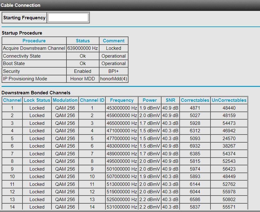

        Here is the connection and channel info.  BTW, I just got another T3 timeout error in the log.
