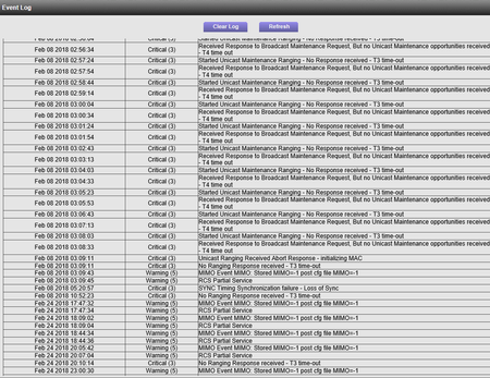

Been reading the forum... and think there is not much i can do before Comcast tech comes out, but wanted to post here to make sure i had answers ready. few months old CM700 - pay for 150Mbps .......

Please post the power values from the connection page.

The power on the first couple downstream channels is high it should be between -7 to +7 and the timeouts could be a sign of signal issues. You will want a tech to check the lines or remove any splitters connected to your cable modem and see if it improves.
