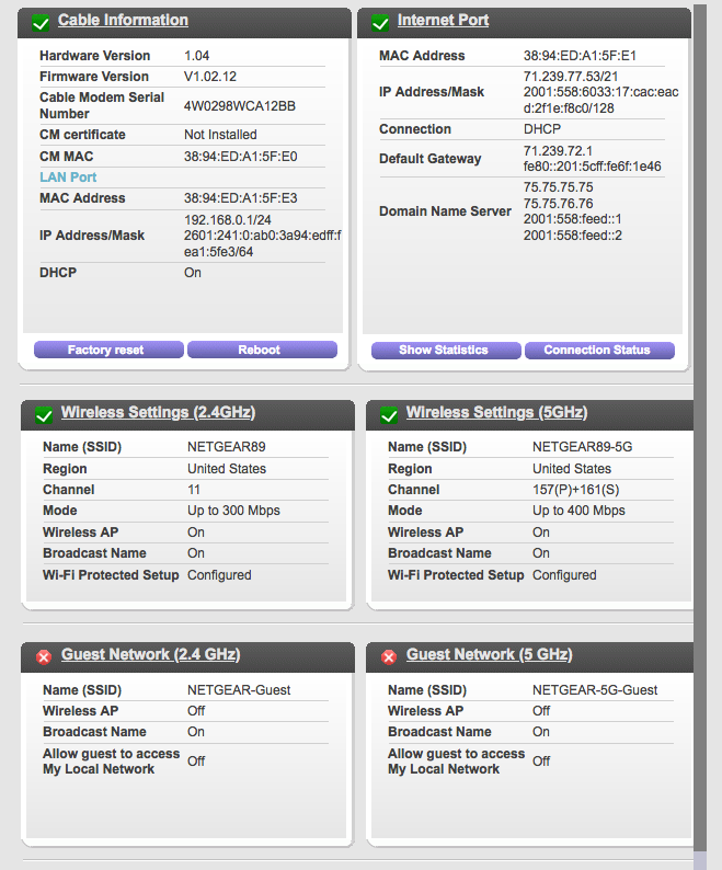

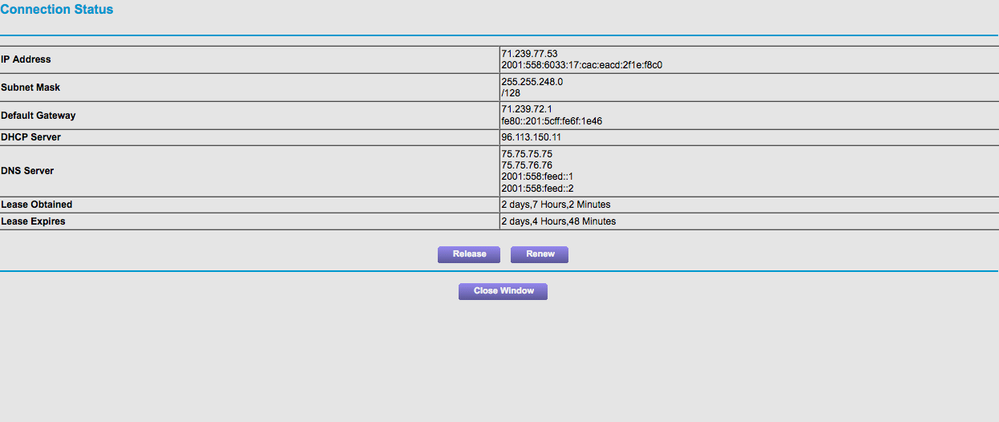

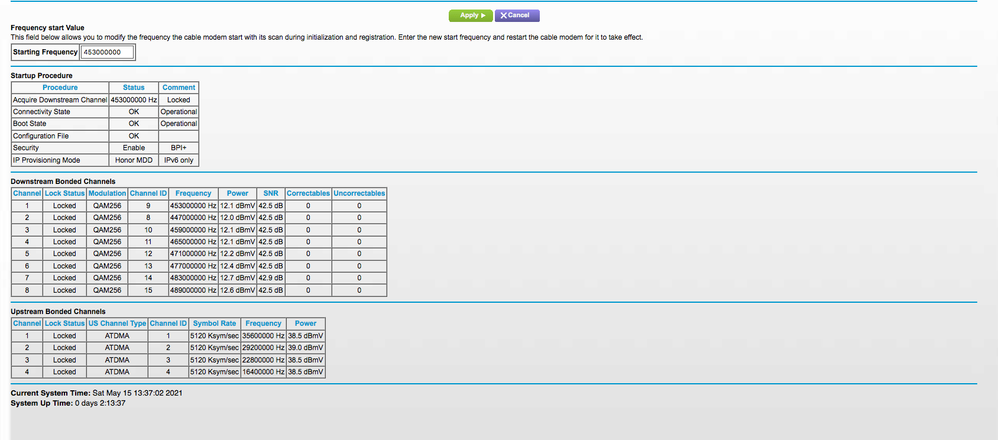

      Wreless and  have done all this.
      Here are some scrennshots as I wasn't sure exactly what you needed.

    • Ghoulardi57's avatar
      Ghoulardi57
      Attached again as requested
