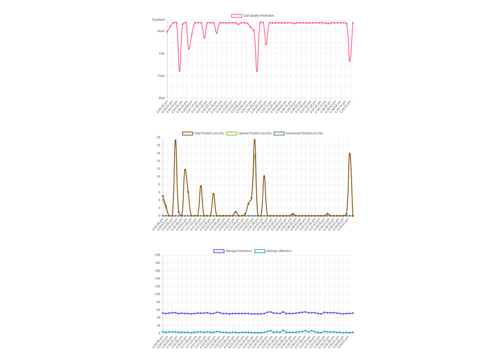

- fliker1802Aspirant
this is what im dealing with idk if this helps put things in perspective or if its even useful information

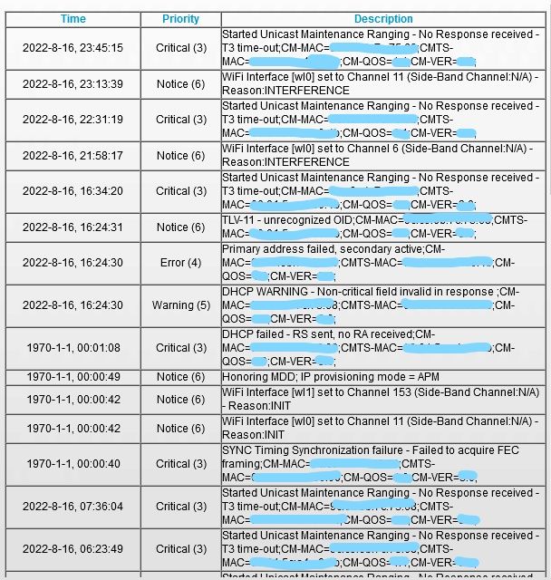

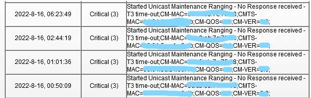

FURRYe38idk if this helps at all but here the logs saying critical error multiple times today (idk what to cover and what not so i covered what i felt needed to be)
Ya you have some errors and criticals that the ISP needs to look into.
