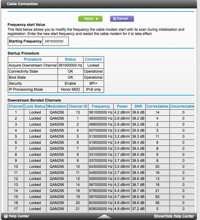

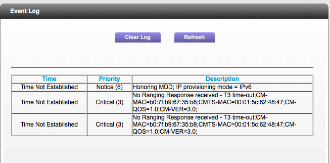

      I hope I did this correctly.
      This information is modem to router to computer.
  • vkdelta's avatar
    vkdelta
    NETGEAR Employee Retired
    power levels are ok.
