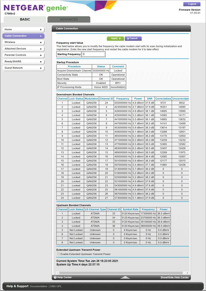

    • BrettJohn's avatar
      BrettJohn
      Here are screen shots of the cable connections and event log pages.
      The weird thing is that none of the physical connections have changed in a couple of years.
      Thank you for your help.

      • plemans's avatar
        plemans
        You have a bunch of errors in your line and your logs are indicating line issues.
        If you already checked your own line/connection, then your isp would need to check it.
