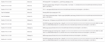

I have confirmed that this firmware downgrade occurred with my modem
I have confirmed that this firmware downgrade occurred with my modem, and that I have received the same notice from Comcast.
Further, I updated to the CM2050V AFTER being notified by Comcast that my CM1150V would not support my speed tier. After the CM2050V being in service for a while, it suddenly failed and had to be RMA with Netgear. I cannot prove anything but suspected that the failure was perhaps a failed firmware update.
It may be purely circumstantial that I now find that there ARE firmware issues, and that the replacement unit has now been downgraded. I am hoping that these issues don't lead to another failure and ordeal getting an RMA.

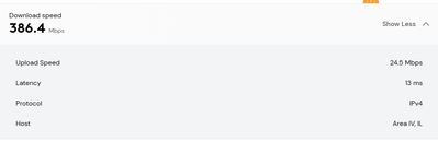

I have confirmed that the bulk of my problem is the Zyxel USG60 router. I put the drop amp back into the circuit as I would normally have it but plugged a PC directly into the modem for testing. While I am still seeing the previous events, with the USG60 out of the path, I am now seeing 940/25.
Apparently, the issues were the USG60 router all along.
As for WIFI, I already have a mesh system with 3 nodes (overkill but works).
I will be exploring firewall/router devices for something that has better throughput based on my service tier. The speed issues are NOT caused by the drop amp!
Thanks for the patience! Any recommendations for firewall/router in this speed tier would be appreciated. I'm considering the NetGate 4100 for a bit of future-proofing that meets by speed tier.

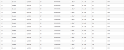

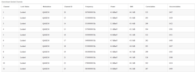

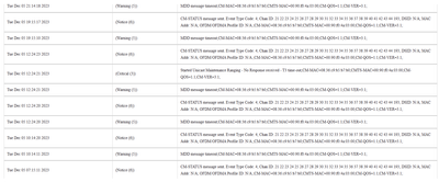

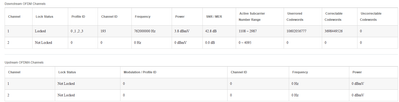

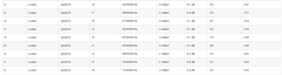

Please post a copy and paste of the modems connection status and event log page.
https://kb.netgear.com/30007/How-do-I-obtain-the-cable-connection-information-from-a-NETGEAR-cable-modem-modem-router
https://kb.netgear.com/30008/How-do-I-view-or-clear-the-event-logs-on-my-NETGEAR-cable-modem-or-modem-routerFYI:
Ok, power levels look good:
https://kb.netgear.com/24311/Power-level-guidelines-for-a-NETGEAR-cable-modem-router
However, we see correctables and un-correctables that should be zero.

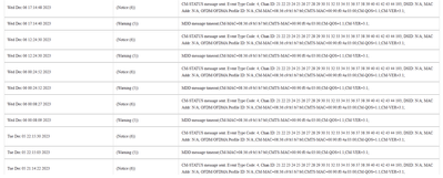

Any Criticals, Errors or Warnings seen in the event logs needs to be reviewed and resolved by the ISP. Indicates a signal issue on the ISP line up to the modem.
