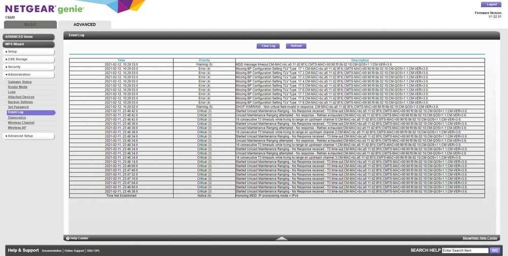

    do you have a screen snip of the cable connections page and the event logs?
    that helps us check the connect back to the isp.

      TimePriorityDescription
      2021-02-12, 10:29:33.0Warning (5)MDD message timeout;CM-MAC=bc:a5:11:d2:8f:fc;CMTS-MAC=00:90:f0:0b:02:10;CM-QOS=1.1;CM-VER=3.0;
      2021-02-12, 10:29:03.0Error (4)Missing BP Configuration Setting TLV Type: 17.1;CM-MAC=bc:a5:11:d2:8f:fc;CMTS-MAC=00:90:f0:0b:02:10;CM-QOS=1.1;CM-VER=3.0;
      2021-02-12, 10:29:03.0Error (4)Missing BP Configuration Setting TLV Type: 17.2;CM-MAC=bc:a5:11:d2:8f:fc;CMTS-MAC=00:90:f0:0b:02:10;CM-QOS=1.1;CM-VER=3.0;
      2021-02-12, 10:29:03.0Error (4)Missing BP Configuration Setting TLV Type: 17.3;CM-MAC=bc:a5:11:d2:8f:fc;CMTS-MAC=00:90:f0:0b:02:10;CM-QOS=1.1;CM-VER=3.0;
      2021-02-12, 10:29:03.0Error (4)Missing BP Configuration Setting TLV Type: 17.4;CM-MAC=bc:a5:11:d2:8f:fc;CMTS-MAC=00:90:f0:0b:02:10;CM-QOS=1.1;CM-VER=3.0;
      2021-02-12, 10:29:03.0Error (4)Missing BP Configuration Setting TLV Type: 17.5;CM-MAC=bc:a5:11:d2:8f:fc;CMTS-MAC=00:90:f0:0b:02:10;CM-QOS=1.1;CM-VER=3.0;
      2021-02-12, 10:29:03.0Error (4)Missing BP Configuration Setting TLV Type: 17.6;CM-MAC=bc:a5:11:d2:8f:fc;CMTS-MAC=00:90:f0:0b:02:10;CM-QOS=1.1;CM-VER=3.0;
      2021-02-12, 10:29:03.0Error (4)Missing BP Configuration Setting TLV Type: 17.7;CM-MAC=bc:a5:11:d2:8f:fc;CMTS-MAC=00:90:f0:0b:02:10;CM-QOS=1.1;CM-VER=3.0;
      2021-02-12, 10:29:03.0Error (4)Missing BP Configuration Setting TLV Type: 17.8;CM-MAC=bc:a5:11:d2:8f:fc;CMTS-MAC=00:90:f0:0b:02:10;CM-QOS=1.1;CM-VER=3.0;
      2021-02-12, 10:29:03.0Error (4)Missing BP Configuration Setting TLV Type: 17.9;CM-MAC=bc:a5:11:d2:8f:fc;CMTS-MAC=00:90:f0:0b:02:10;CM-QOS=1.1;CM-VER=3.0;
      2021-02-12, 10:29:02.0Warning (5)DHCP WARNING - Non-critical field invalid in response ;CM-MAC=bc:a5:11:d2:8f:fc;CMTS-MAC=00:90:f0:0b:02:10;CM-QOS=1.0;CM-VER=3.0;
      2021-02-11, 23:48:42.0Critical (3)Started Unicast Maintenance Ranging - No Response received - T3 time-out;CM-MAC=bc:a5:11:d2:8f:fc;CMTS-MAC=00:90:f0:0b:02:10;CM-QOS=1.1;CM-VER=3.0;
      2021-02-11, 23:48:42.0Critical (3)Unicast Maintenance Ranging attempted - No response - Retries exhausted;CM-MAC=bc:a5:11:d2:8f:fc;CMTS-MAC=00:90:f0:0b:02:10;CM-QOS=1.1;CM-VER=3.0;
      2021-02-11, 23:48:42.0Critical (3)16 consecutive T3 timeouts while trying to range on upstream channel 0;CM-MAC=bc:a5:11:d2:8f:fc;CMTS-MAC=00:90:f0:0b:02:10;CM-QOS=1.1;CM-VER=3.0;
      2021-02-11, 23:48:36.0Critical (3)Started Unicast Maintenance Ranging - No Response received - T3 time-out;CM-MAC=bc:a5:11:d2:8f:fc;CMTS-MAC=00:90:f0:0b:02:10;CM-QOS=1.1;CM-VER=3.0;
      2021-02-11, 23:48:36.0Critical (3)Unicast Maintenance Ranging attempted - No response - Retries exhausted;CM-MAC=bc:a5:11:d2:8f:fc;CMTS-MAC=00:90:f0:0b:02:10;CM-QOS=1.1;CM-VER=3.0;
      2021-02-11, 23:48:36.0Critical (3)16 consecutive T3 timeouts while trying to range on upstream channel 2;CM-MAC=bc:a5:11:d2:8f:fc;CMTS-MAC=00:90:f0:0b:02:10;CM-QOS=1.1;CM-VER=3.0;
      2021-02-11, 23:48:34.0Critical (3)Started Unicast Maintenance Ranging - No Response received - T3 time-out;CM-MAC=bc:a5:11:d2:8f:fc;CMTS-MAC=00:90:f0:0b:02:10;CM-QOS=1.1;CM-VER=3.0;
    • -Enrique-'s avatar
      -Enrique-
      hope this helps. No matter what I tried. Nothing worked.
