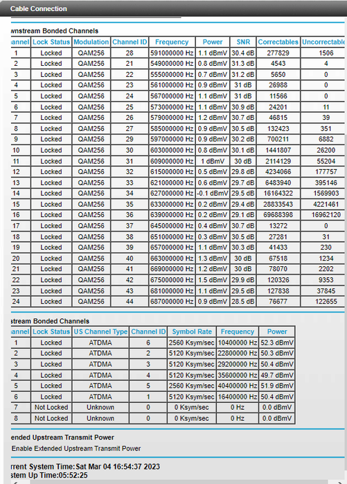

I recently purchased my Netgear C7000v2 modem/router and I am having terrible download times when I check with speedtest.net and Xfinity's speed check. My Download channel light blinks even though all download channels are locked. When it is bad, my download channel SNR values run from 27.4 to 30.6 dB and the download speed is 3.8 Mbps. When I get my normal download speed of around 90 Mbps, my SNR values are 29.1 to 31.5 dB .
I had a service tech from Xfinity come out to check the connections and he found a broken cable outside, but he looked at my readings from the modem/router and said that the SNR value should be above 33 dB and he said that it must be the outside service from the street that is bad. He couldn't check that, but put in a service order for me. I haven't heard anything since from Xfinity.
This is a large retirement campus (42 acres) with Xfinity internet service going to many individual units.
Here is my current channel status.
Any suggestions would be appreciated.
Thanks, Chuck
You'll have to wait on the service ticket. You do have a bunch of errors and if the tech is still getting them when he's directly connected to the outside cable, its coming from the hub connection somewhere. Not much to do on your end but call occasionally so they don't "forget" about it.

https://kb.netgear.com/30008/How-do-I-view-or-clear-the-event-logs-on-my-NETGEAR-cable-modem-or-modem-routerYou have a ton of correctables and un-correctables that should be all zeros.

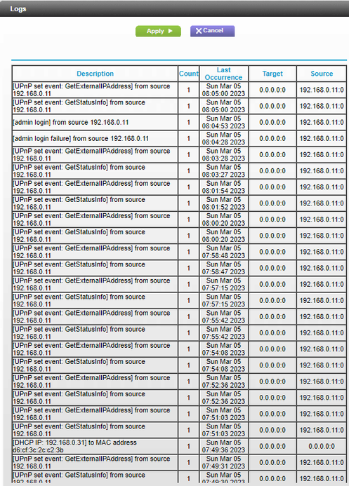

Here is a snapshot of my log.
- plemansGuru - Experienced User
That's the standard router logs and not the event logs. Similar location in the GUI but called event log
