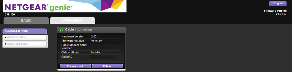

Hi, I have a Netgear CM1100 using firmware version V2.01.02. I did a routine scan on my network using NMAP and noticed that the modem is listening on both 192.168.0.1 and 192.168.100.1. I know that...

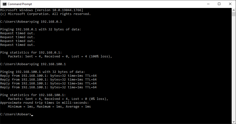

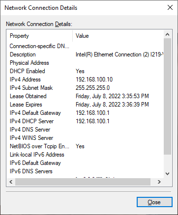

Thanks for the help FURRYe38 . I ended up just removing the netgear modem and using my old modem until I can figure out what is going on here. It makes me uncomfortable that it is advertising an IP address that is not documented anywhere. Also that the IP address is linked to a web server.

So I took out my CM1100 and 1200 today and check them both.
Both don't exhibit this issue with .0.1 address being made available.
- johnalamedaJul 09, 2022Aspirant
Thanks FURRYe38 for checking this. Are you able to access http://192.168.0.1 from a browser? When I tried pinging 192.168.0.1, the pings were lost similar to your results. However, I was able to access it from the browser. Also, I was able to scan it with NMAP ( nmap 192.168.0.1 ) as well.
