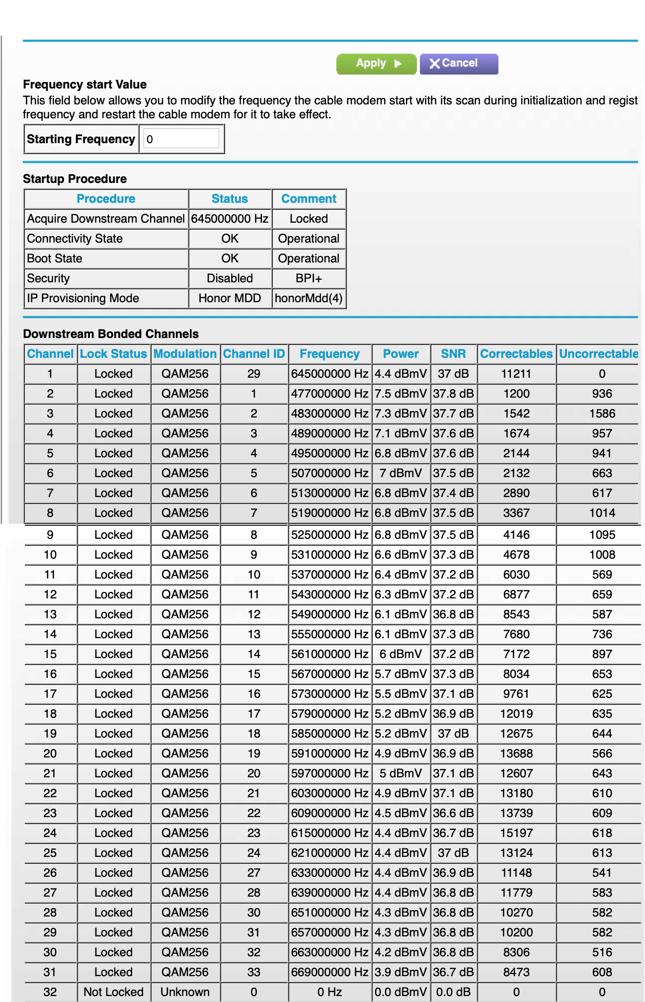

I have been having issues with erratic downstream speeds that will cut out completely at times up to 974mbps using Xfinity raspberry pi speed tester. I only manage to get speeds of 25mbps to 640mbps using a macbook pro with 10/100/1000 port through a cat8 to the modem.
Channel 1-31 of the downstream are locked on with good numbers. Channel 32 is not locked on. Upstream is the first 4 locked on. Upstream speeds are roughly 32-40mbps.
OFDM downstream is one channel locked on.
xfinity techs measure good signal with no noise issues.
I am curious about the boot file for this modem and the firmware.

    DarrenM
    Sr. NETGEAR Moderator
    Are you able to post your modem logs and the power levels of the modem?

      Downstream before 30-30-30 reboot.
