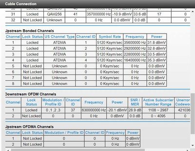

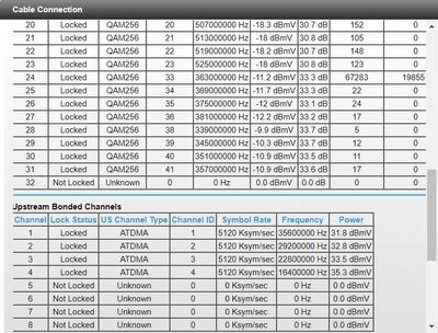

Off and on my downstream led starts blinking and I loose my internet. I have seen some previous posts but I though I would post my connection. Looks like 24 is an issue. Any guidance is appreciated.
- Have the ISP take a look at the information I pointed too.
11 Replies
- FURRYe38Guru - Experienced UserPower is too LOW and you have a ton of correctables and un-correctables that should be zeros. https://kb.netgear.com/24311/Power-level-guidelines-for-a-NETGEAR-cable-modem-router Please post a copy and paste of the modems event log page.
