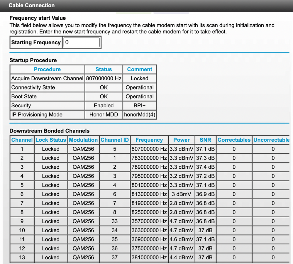

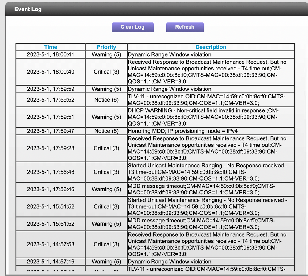

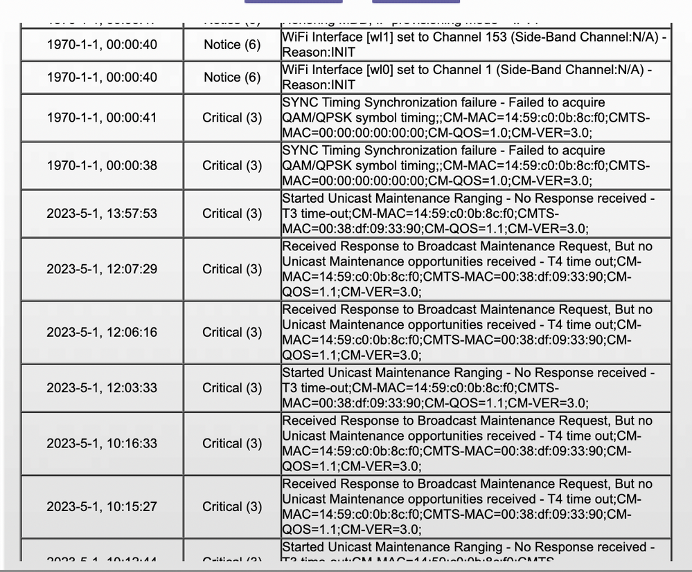

have cox and they keep telling me to contact Netgear. The firmware version I am running on is V1.03.01. Below are screen shots to my event log and cable connection. Is anyone able to tell me if this is a line problem?

    Yes, Any Criticals, Errors or Warnings seen in the Event logs are a line issue that the ISP needs to review and resolve.

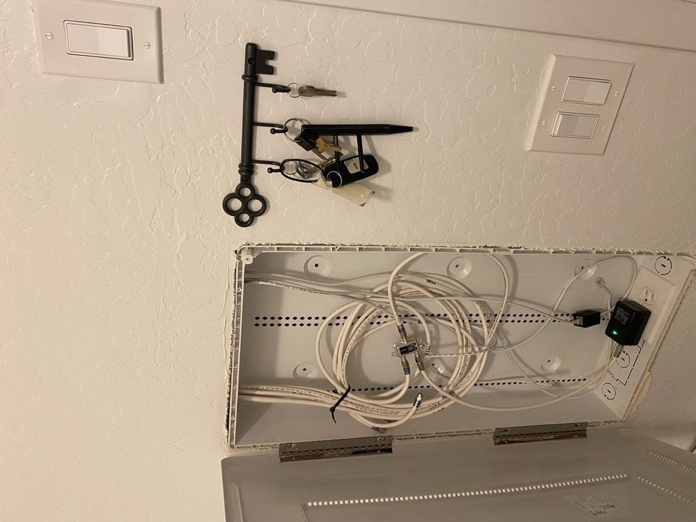

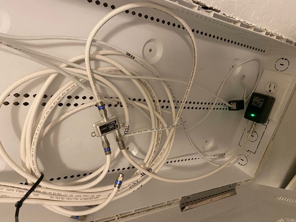

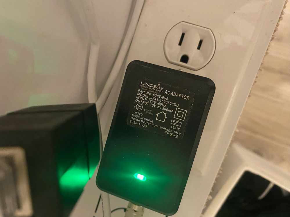

      As far as splitters go, below is a picture of the cable feed in my house. You can see a splitter is taking the feed from outside and connecting it to 1) the main coax outlet in my office (this is where my modem is) and 2) An apparent power source. I'm not sure what the power source is being used for. Perhaps you know? If I remove the splitter, that power source will be eliminated. If the power source isn't needed, I could use a coax bridge to connect the outside cord to the one running into my office. Unfortunately, there is no ethernet outlet in that cable box, so I cannot put my modem/router in there.
      In another picture, you'll see a random switch that sits above my keys. When I flip that switch, nothing noticeable happens. Could this have any impact on anything? I know it's a long shot, but I figured I would at least ask.

      • plemans's avatar
        plemans
        That power source looks like a amplifier/booster for something. But it runs to a splitter, not an amplifier.
        If nothing else is connected to that coax line, remove that power source and just direct connect the 2 cables together.
        might clean up the line quite a bit.
  • plemans's avatar
    plemans
    Something is in the line causing issues.

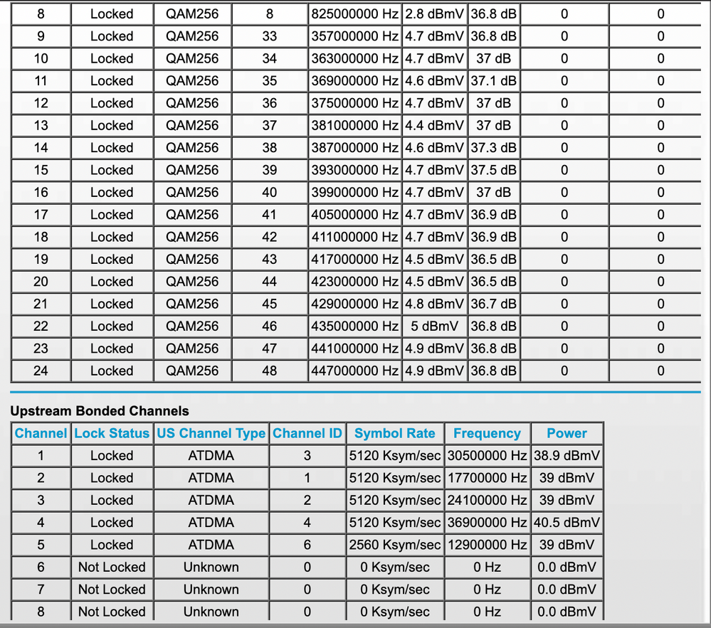

    Reason why is the value of your upstream would mean you're right next to a hub. But your downstream values indicated your not that close. So something in there is acting as an attenuator but not doing that great a job because you're getting dynamic range window violations. Those violations mean you're power is going out of spec.
    So if you have a signal attenuator or amplifier in line, remove them and recheck
