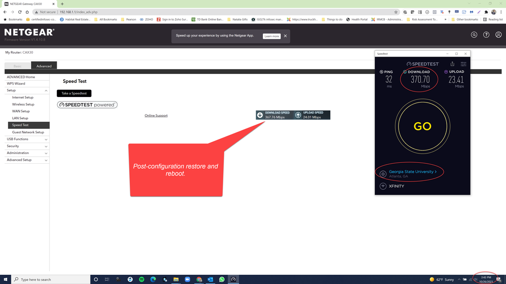

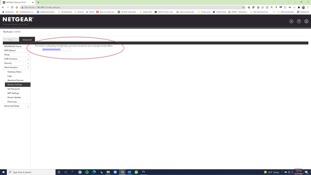

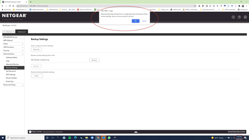

I screen captured some tests for you to see I am not crazy. Each test is time-stamped.
1. I performed two "Pre-reset" tests. In the first test, I used Speedtest on the console and Speedtest running on my 5Ghz connected laptop simultaneously, wiht the laptop connected to my ISP as the test server. In the second test, I tested the console and my laptop connection simultaneously using a local university as the test server for my laptop.
2. I then re-loaded my saved backup config of the very configuration running on the router at the time of the tests. The screencaps are timestamped.
3 I then repeated the speedtests from the console and my laptop, with the laptop testing against the same test servers as before.
Result: I doubled my download speed within a few minutes by re-loading a backup config and rebooting. Again.
I get the same result if I perform a hard reset and reconfigure the router manually. It's just a lot more work.
See attached.
