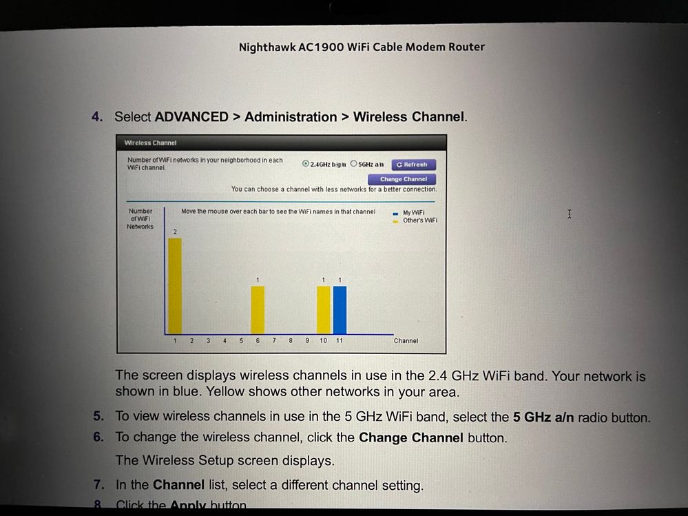

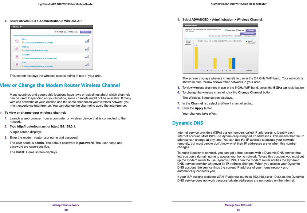

Problem solved after hours of troubleshooting. Short answer, the auto channel function was selecting same radio channel that several others in same apartment complex were also using. Went to manual and selected a channel that wasn't being occupied by other like devices and internet returned along with Ring camera's being functionally operable. Why doesn't this software have same like software function as my old Nighthawk AC1900 WiFi cable modem has for manual selecting after finding unused channels. See picture below on the right with bar graph:
Had to power up my older AC1900 to find a 2.4Ghz channel that was free (see above pictured bar graph currently not available in CAX30), otherwise the auto channel feature of CAX30 would pick channels that had as many as 5 user devices broadcasting from that my internet would be offline while connected on the WiFi 2.4Ghz bands. The auto channel on the 5Ghz channels never had any issues and the 1GB service was also blazing in 5Ghz and ethernet chords. Hope that Netgear reads this and installs the software "Number of WiFi networks in your neighborhood in each WiFi channel" in the an update very soon or this very same issue will be unwelcomed to anyone having to spend countless hours of no service for a simple fix that i have not found mentioned in this forum. My apologies in advance if i missed something.

      Thanks for the suggestion and i looked up the WiFi scanners and went with S4N for my MacBook pro. Great more details as you have shared. My previous post using the AC1900 to find free channels was also coupled with my Ring cameras "Device Health, Signal Strength RSSI-#'s for performance of the router. Now that you turned me towards a WiFi scanner (previouly was not aware of) for download is way better option. Cheers!
