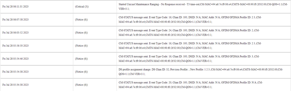

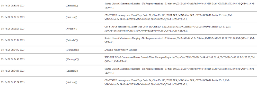

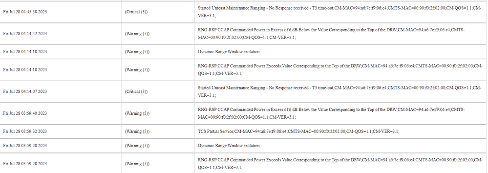

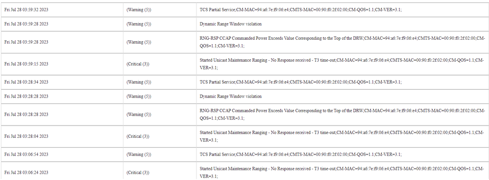

I was wondering if anyone can help me decipher these logs. The blinking lights and connection issues started recently, Same products and set up were fine for years. I do have a few splitters since it is a 1960's house so I am thinking it might be a Coax issue but was hoping for some initial decoding of the logs to help me navigate.

Any Criticals, Errors or Warnings seen in the event logs needs to be reviewed and resolved by the ISP. Indicates a signal issue on the ISP line up to the modem. https://highspeed.tips/docsis-events/

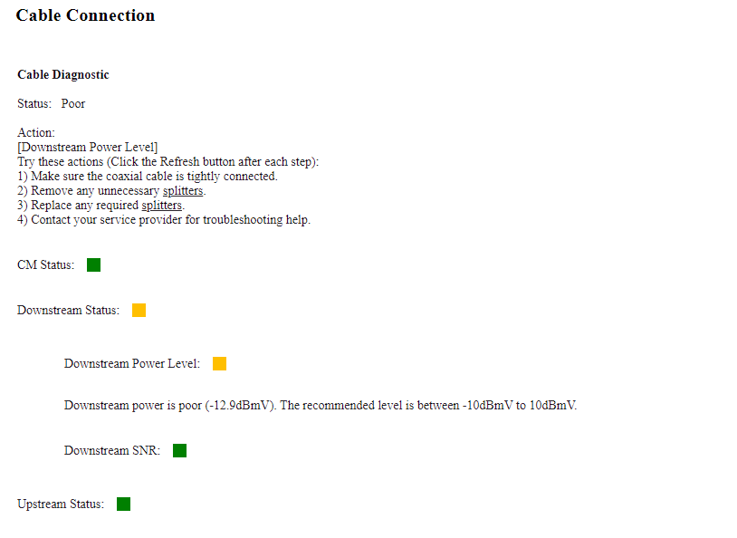

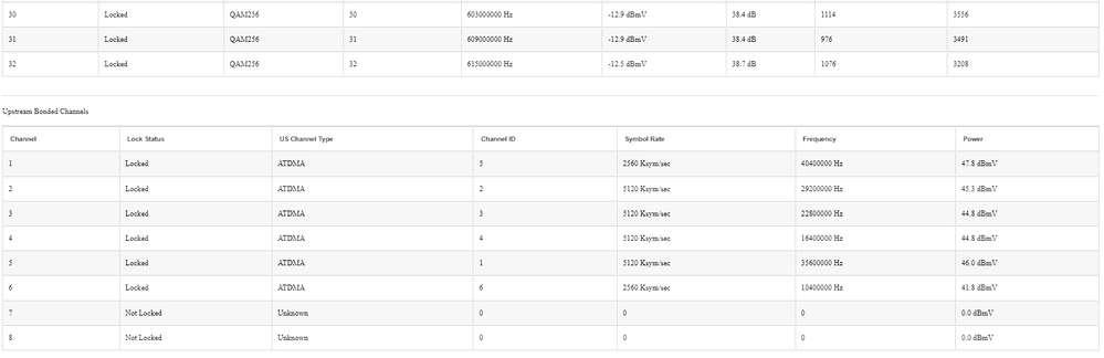

When I did go to the Cable Connection log it was showing Status poor which I will paste here but definitely going to start going through the action list as quick as I can. I don't have any splitters but there are some female to female extenders on the way (possibly 2) so not sure if that can cause issues.
Power levels are too low and below spec and need to be raised:
https://kb.netgear.com/24311/Power-level-guidelines-for-a-NETGEAR-cable-modem-router

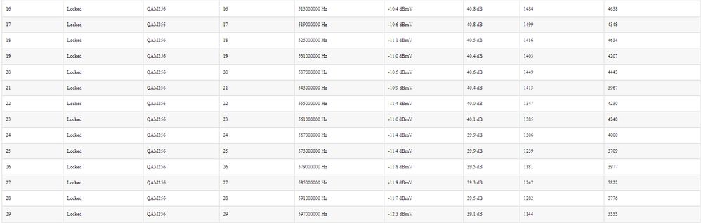

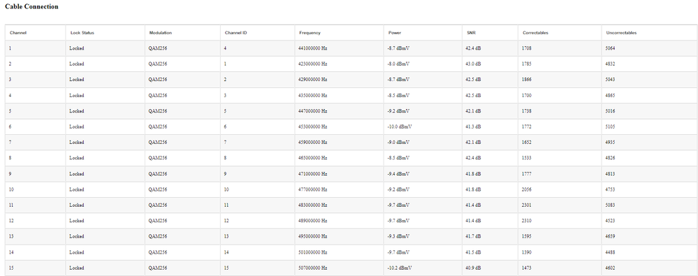

You have correctables and un-correctables that should be Zero.
Have the ISP check the signal and line quality UP to the modem. Be sure the ISP provisions the modem correctly.
