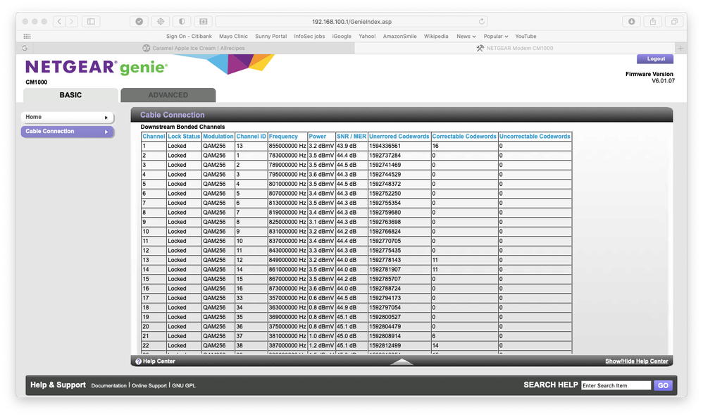

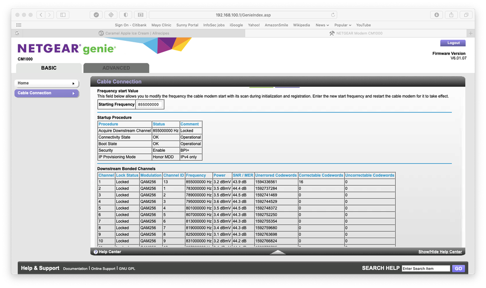

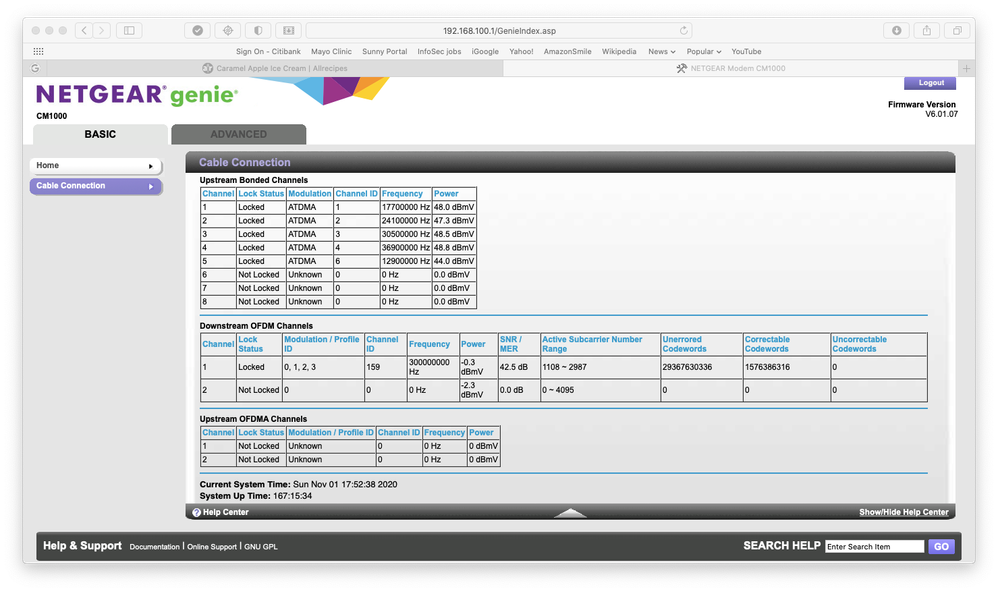

I've been experiencing intermittent internet connection issues since upgrading to a Halo mesh router about 1.5 months ago. Things were rought for about the first 1-2 weeks, and then suddenly corrrected itself. It's been three months since then and the errors are back again. Nothing has changed I can think of.
When I look on the Netgear admin page I'm seeing streams of errors but I don't see any informaiton on the nature of the errors. It says they are correctable but no insight into how.
Including screenshots.

        Your power levels and errors are normal and within the optimal range.
        Its when you get the uncorrectable errors you really want to worry.
        whats more important is the logs. The cable connections page are just a snapshot. The logs give us more info.
