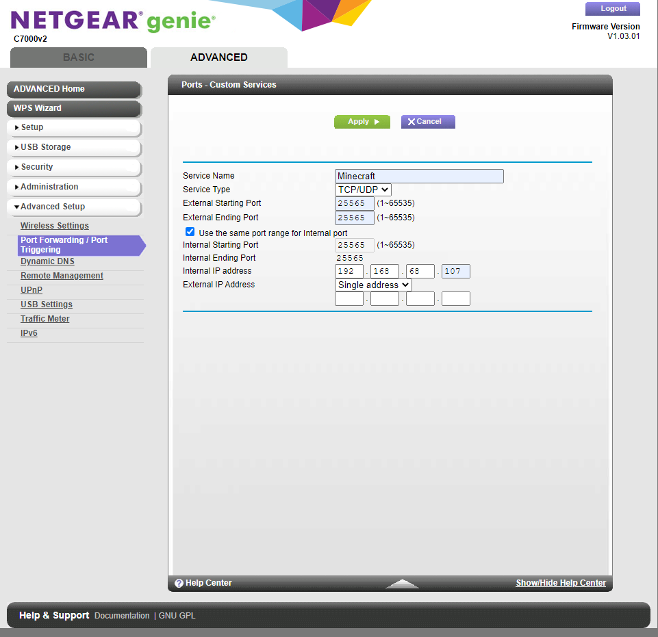

I am trying to port foward for Minecraft with the port 25565.
Service Name: Minecraft
Service Type: TCP/UDP
External Start/End Port: 25565
Box is checked to use the same port range for internet start/end port
I'm using my PC's IPv4 address under Internal IP address.
I'm using my external IP address that I find on the site https://www.whatismyip.com/
When I pressed apply, the notice says "Invalid Data. Internal IP Address is not in LAN!"
I even tried every the same as above ^ but instead of putting my external IP Address from https://www.whatismyip.com/ , I've tried putting "Any". I still get the same notice.
What does this mean? What am I doing wrong? My apologies, I am not too tech savvy.

  • This image is what I see, I've seen other older threads that has a box below where you can click with IP to use, but I'm assuming that is no longer an option.
         What is its address?
         "using" how?  The "External IP address" option in the "Custom
      Services" form refers to the remote client, not to anything related to
      your router.  Select "Any" for that, not any specific address.
         I wouldn't necessarily trust that error message, but I can't see the
      actual data on your form, so what do I know?

         If your Minecraft-server Windows system is connected to the Deco
      system, and its IP address is on a different subnet from the C7000v2
      LAN, then that would explain the "not in LAN" complaint from the
      C7000v2.
         Are you using the wireless-router features of the C7000v2, or are all
      your client devices connected to the Deco system?
      > Edit 2: Port forwarded my deco as well, tried to port forward once
      > again through the main router, same notice.
         Not amazing.
         You seem to have too many routers.  That is, more than one.  The
      usual one-router options would be (1) Configure the C7000v2 as a modem
      only, using the Deco router as a router, or (2) Leave the C7000v2 as a
      modem+router, and configure the Deco router as a wireless access point
      (which may or may not be possible).  Then you'd configure the port
      forwarding on your remaining (one and only) router, whichever gizmo that
      is.

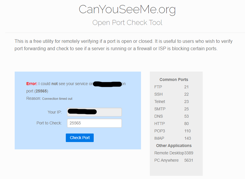

        (which may or may not be possible).  Then you'd configure the port forwarding on your remaining (one and only) router, whichever gizmo that is.
