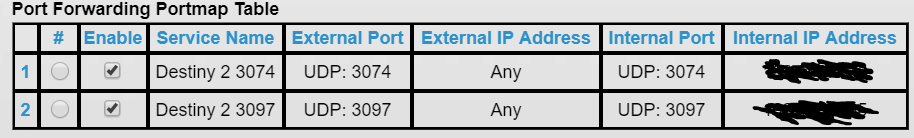

Hi, I'm trying to forward some ports on from my router to my PC but am having quite a bit of trouble.
As you can see in the screenshot below. I have added both of the required ports to allow communications via my modem & PC.
However when I check if the ports are open via the following website, it states that they are both closed. -https://www.yougetsignal.com/tools/open-ports/

       There's no reason to hide the Internal IP Address value(s).  What is
    the IP address of that target server?  What have you done to ensure that
    it always has the address which appears in the port-forwarding rule?
    > [...] when I check if the ports are open via the following website, it
    > states that they are both closed. [...]
       Are you specifying the right external/public IP address for testing?
    Is that the WAN/Internet IP address of the router?
       Is the server program running on the target server system?
       The usual problems with this stuff are:
       1. Wrong external IP address (different from the port-forwarding
    router's WAN/Internet IP address).  (An intermediate NAT router, for
    example, could cause this.)
       2. Bad port-forwarding rule (wrong port(s), wrong target address --
    including a wandering target).
       3. Server not listening on the port-forwarding target/server system.
       4. External influences: ISP blocking, other firewalls, ...

      What have you done to ensure that it always has the address which appears in the port-forwarding rule?
      I've tried going into the ipv4 address settings but whenever I assign a static IP address I lose network connectivity.
      >Are you specifying the right external/public IP address for testing? Is that the WAN/Internet IP address of the router?
      The IP address being used to test is that of my router.
           I don't know what that means.  Which "the ipv4 address settings" do
        you mean?  "whenever [you] assign a static IP address" to what?  Are you
        fiddling with the settings on your computer (in secret ways)?  I'd
        expect there to be an Address Reservation table under some location like
        ADVANCED > Setup > LAN Setup, and reserving an address there might be
        simpler/safer than trying to assign a static address on the computer
        itself.
           Each interface of your router has its own IP address.  The LAN
        interface has one, and the WAN/Internet interface has another one.  What
        is your router's WAN/Internet IP address?  (The first two octets of what
        should be your public IP address ("a.b" out of "a.b.c.d") will do, if
        you don't want to reveal the whole thing.)
           What is the target server ("Internal") IP Address in your
        port-forwarding rules?
        > [...] What is the IP address of that target server? [...]
           Still wondering.
           Still wondering.
