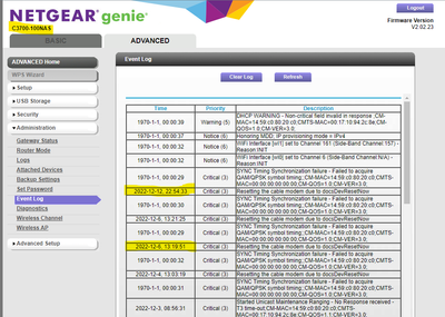

The cable connection file is attached. I'll send the event log files in a separate reply (I'm limited to one attachment here).
All your logs are from a C3700 gateway, do you have these for the CM2000?

Regarding the log data, Is there a way to toggle to other data that's been captured for a different modem other than the one that's currently in use? The dates on which I attempted to change the modem are included in the data that's presented (see snip below). The time stamps align with when I rolled back to the C3700 unit, which is also a Netgear model. Is there a toggle hidden somewhere that would reveal data for the CM2000 during the time periods that I had thee device connected to the RAX unit? If not, what you see is all there is.

You need to disconnect the 3700 modem and connect up the CM2000 modem...Get it connected with the ISP and associated. Then have 1 wired PC connected to the CM2000 then capture the cable connection and event logs page data.
