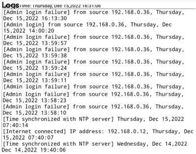

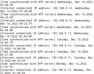

I have some additi0nal information that may crack this case:
I used my phone to access the RAX via Routerlogin.net, where I was able to secure log dating back to 12/12 (see below). The data may or may no9t be of value.
I also discovered that the unit is in Ap mode, which I suspect is the primary contributor to the problem I've been having trying to get the device to work with the CM. My thought is that I should uncheck the AP box immediately before trying to install the CM unit, and assuming that there is not a FM issue, I should have better success .... thoughts?
- FURRYe38Dec 15, 2022Guru - Experienced User
Um, yes, curious on how it would have got into AP mode.
If you can access the routers web page, you could set the back to Router mode which is needed here.
Or press the reset button for 10 seconds then release. Set up the router from scratch with a wired PC and web browser at 192.168.1.1
Good find...
