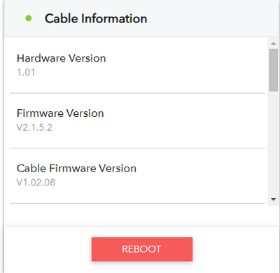

      Firmware is the latest V2.1.5.2

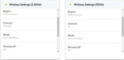

      Channel is set to 36 for 5ghz, and auto for 2.4ghz.

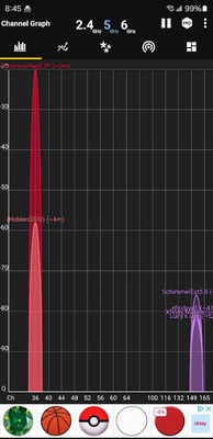

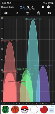

      I did think about channel interference as a cause for this - I just downloaded a free Wi-Fi spectrum analyzer on my phone, and took readings next to the CAX80 for both 2.4 and 5.0. The SchimmelNet 2.4 and 5.0 are the CAX80. The 2.4 spectrum is crowded but the CAX80 appears to be selecting a free channel. I just realized there is a hidden SSID on the same channel as my 5ghz. I wonder if that could be an issue? Does the CAX80 not auto select channel for 5ghz?

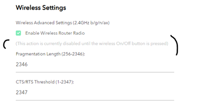

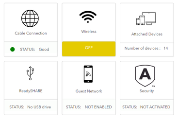

  • Well, it did it again today. This time, before unplugging the CAX80, I went into the GUI page to see what it showed. It showed the WiFi as "Off".
    Except, nobody turned WiFi off.
    What the heck? I can GUARANTEE you nobody in my house pressed the WiFi button on the CAX80. But the modem is saying it's off.
    So here's the next question - if you press the WiFi button on the front of the router, does it turn back on? NOPE! I tried both short press, and long press. WiFI doesn't turn back on. (and no, I'm not pressing the WPS button by mistake).
