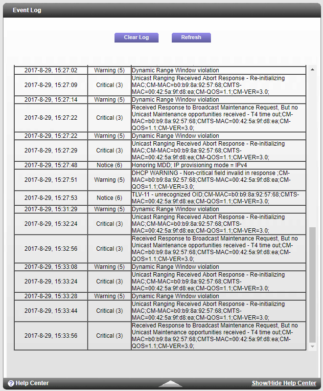

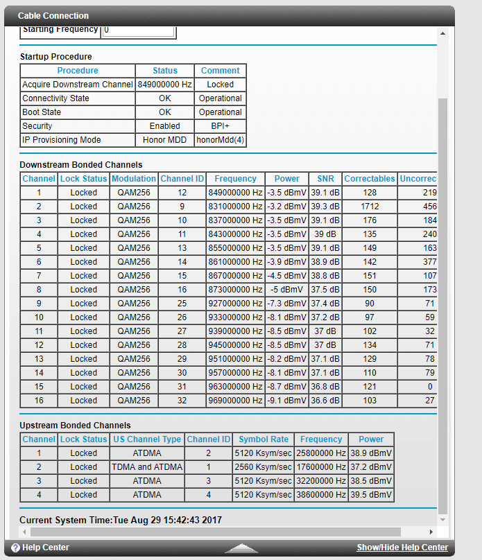

  • I dont know if this will help, but here is event log and my connection.

      I would say its still a signal/line issues you are getting alot of uncorrectables on all downstream channels and you are getting T4 timeouts. it could be a issue down the line somewhere in your neighbor hood.
