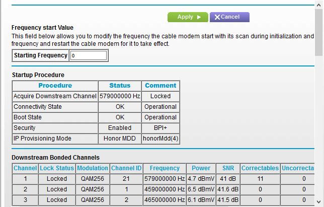

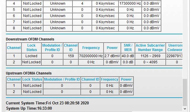

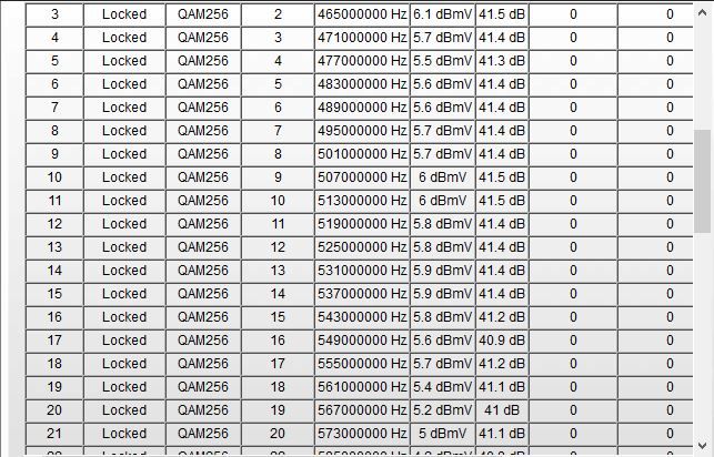

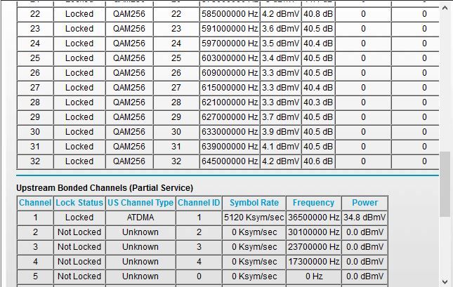

      Here are the screenshots of the cable connection.  5 attachments.
      There are no 'enhancers' attached.  Checked connections.
      Thanks, Curtis

        Your upstream power is low. You should be greater than 37dbmv. You should also have more locked channels. If the modem isn't communicating properly back to the cmts, you can have issues.
        If you don't have any splitters, attenautors, amplifiers in line and the coax all looks good, then you'd need to check with the ISP.
