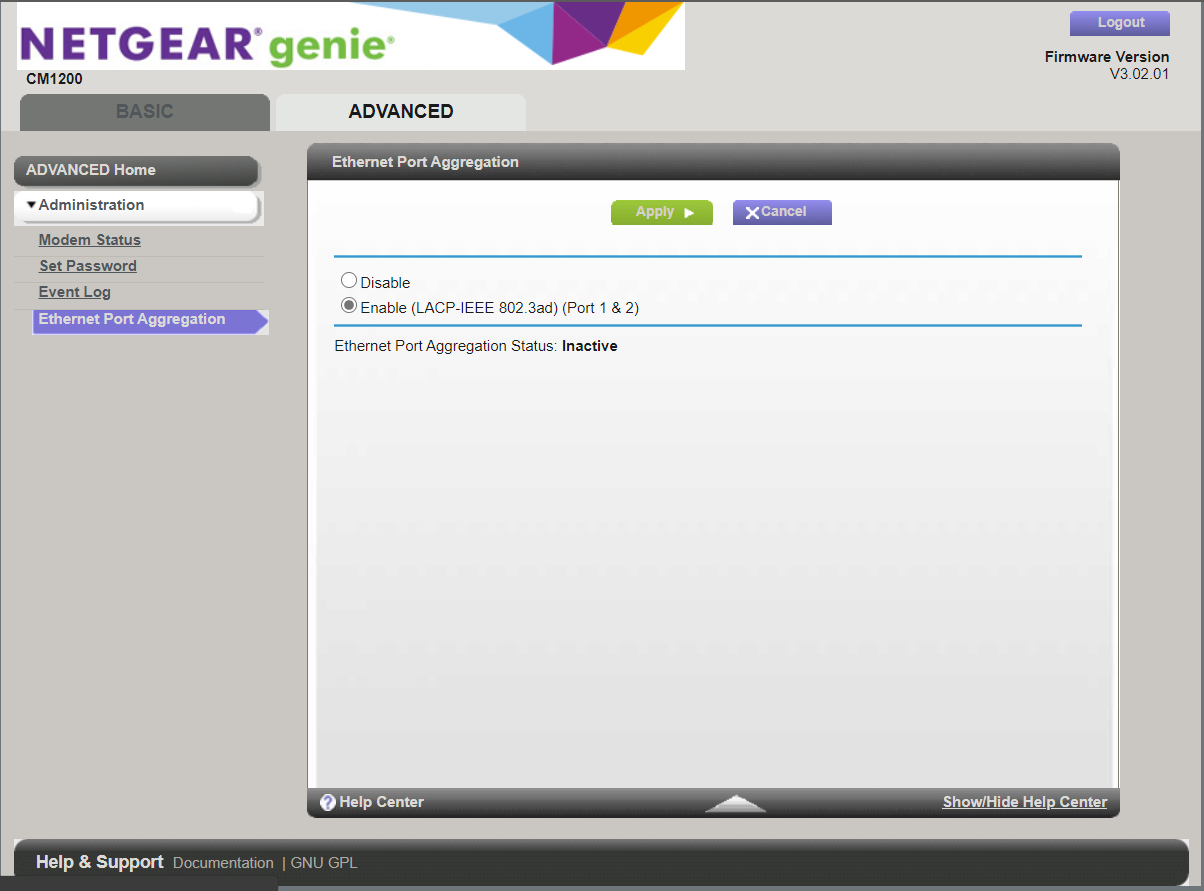

      • Thanks for the response. I have selected Ethernet Port Aggregation Status and rebooted the device. However, upon looking at the status (see attached) it is saying it is inactive. Is that ok? Should I try a hard reboot (unplug the system rather letting the software to reboot it)?
        After doing that I have cleared the logs to see if the issue comes back.
        Will respond back. Thanks!
