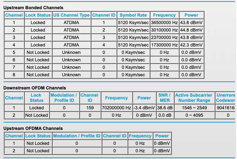

A few weeks ago, (possibly coincidentally) the same time everyone started working from home due to the pandamic, I have been having issues with my internet - especially gaming. I have spent a considerable amount of time troubleshooting with minimal success. Currently having latency spikes, packet loss and a high number of uncorrectable errors on the Netgear CM1150v.
To date I have taken the following steps:
- Fixed signal levels to modem - as you will see in the attached screenshots, my modem signal levels are all within spec now. With my 'old setup' the RF 'in cable' was connected to a splitter which then connected to a commscope CSAPDU9VP amp. I rewired to have my RF 'in cable' direct to the apmlifier and my signal levels were drastically improved. Downstream went from -9dBmV/SNR 36 to -3dBmV to 0dBMv and SNR 38-40. Upstream went from 50+ to mid 40's.
 - Replaced Arris TG862G with the Netgear CM1150V
 - Bypassed the R7000 and direct connected modem to xbox
 - Current firmware on all hardware
 - Tried different ethernet cables
 - Checked all coax connections, all have new fittings and no snags
 - Xfinity came out and checked the pole - signal level in road is good
Attaching photos of my modem status (note the modem was restarted last night - prior to the restart I had uncorrectables on nearly every channel) Also attaching a diagram of my network setup. If anyone has any thoughts I would greatly appreciate it. This has become incredibly frustrating.

 - plemansGuru - Experienced User
You've got errors on channels 30-32.
Problem with adding an amplifier. Yes it gets your signal to the good range. but if you're amplifying a bad signal it doesn't help. and can create issues on the upstream.
Try this. directly connect the modem to right where the coax enters the home. without the amplifier or any splitters. use the setup for a little while (to get some data moving), then take the same screen snips. lets see what it looks like then.
If that all looks good and the signal doesn't have errors and can tolerate a splitter then we move on from there.
the prefered way to run with cable tv and modem is a dual splitter when it enters the home. One leg goes directly to the modem and the other to amplifier/additional splitters needed. TV's and voip tend to tolerate erros/signal amplification better.
this gives the best signal to the modem with the least amount of issues.

plemans Thank you! I will definitley try that. Currently the splitter I have is a 4 way due to the amount of outlets in the house. If I run a 2 way splitter off the main line, I will have to run one more splitter off the amp.
So new setup would be:
Main line into 2 way splitter --> 1 line direct to modem, 1 line to 'in' amp
Amp 8 channels --> 1 line to additional 2 way splitter
