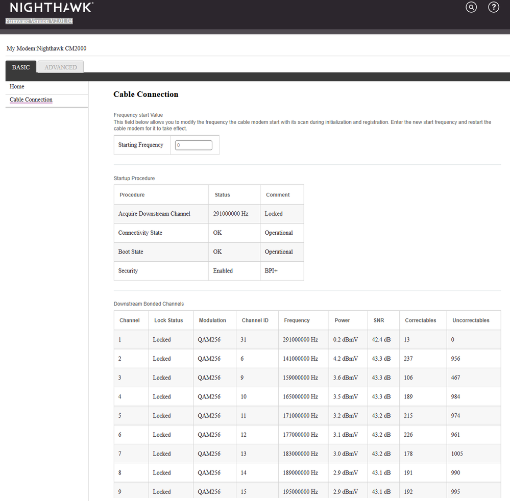

"US profile assignment change. " and "DBC-REQ Mismatch" in modem event log
Every once in a while I'll get a massive lag spike that I can plainly see happen because I am running PingPlotter while playing a game to monitor my connection. Since I don't know what is causing it ...

Please post a copy and paste of the modems connection status page.

- zeth07Jul 05, 2026Aspirant
Firmware: Firmware Version V2.01.04

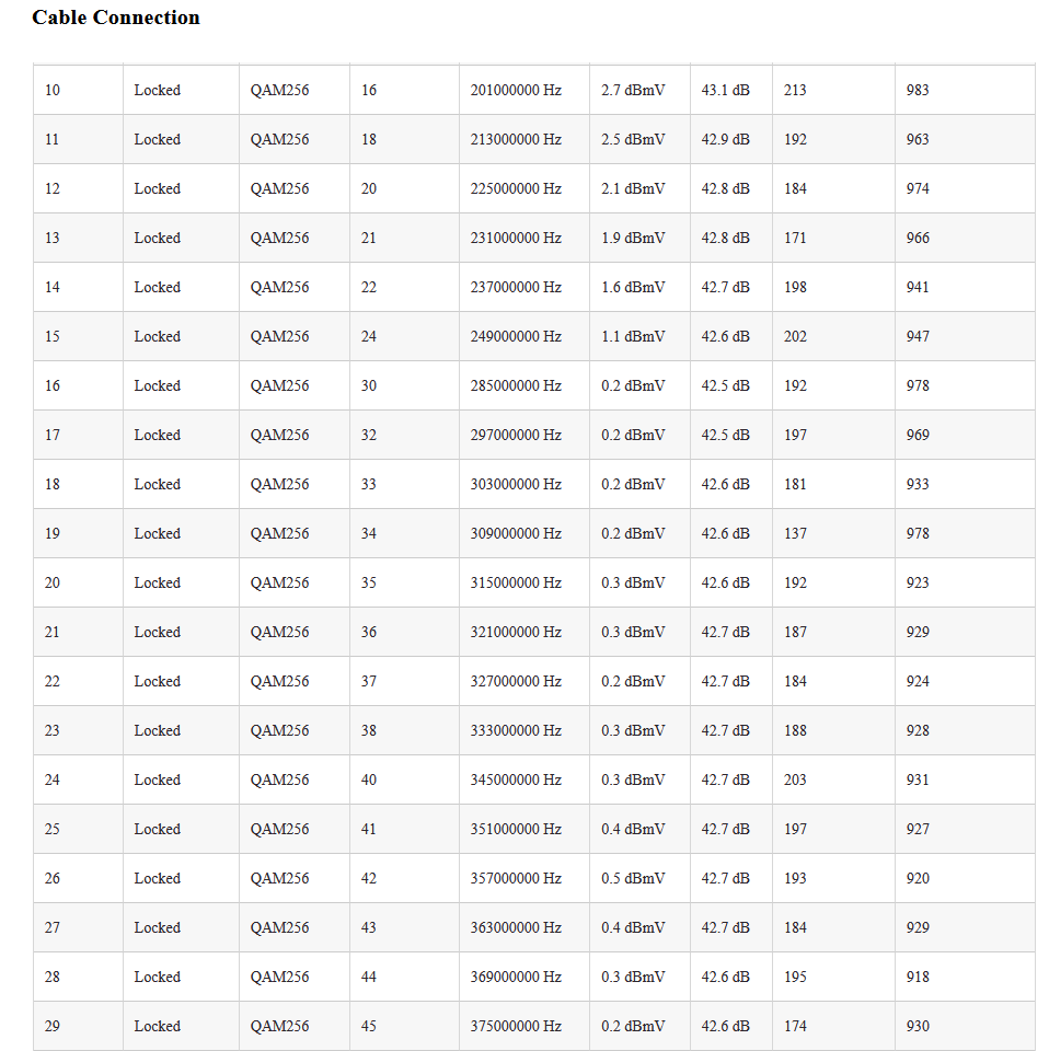

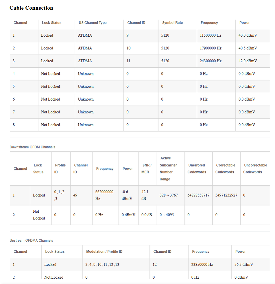

- FURRYe38Jul 05, 2026Guru - Experienced User
Lots of correctables and un-correctables that should be mostly zeros.
Have the ISP check the signal and line quality UP to the modem. Be sure the ISP provisions the modem correctly.
