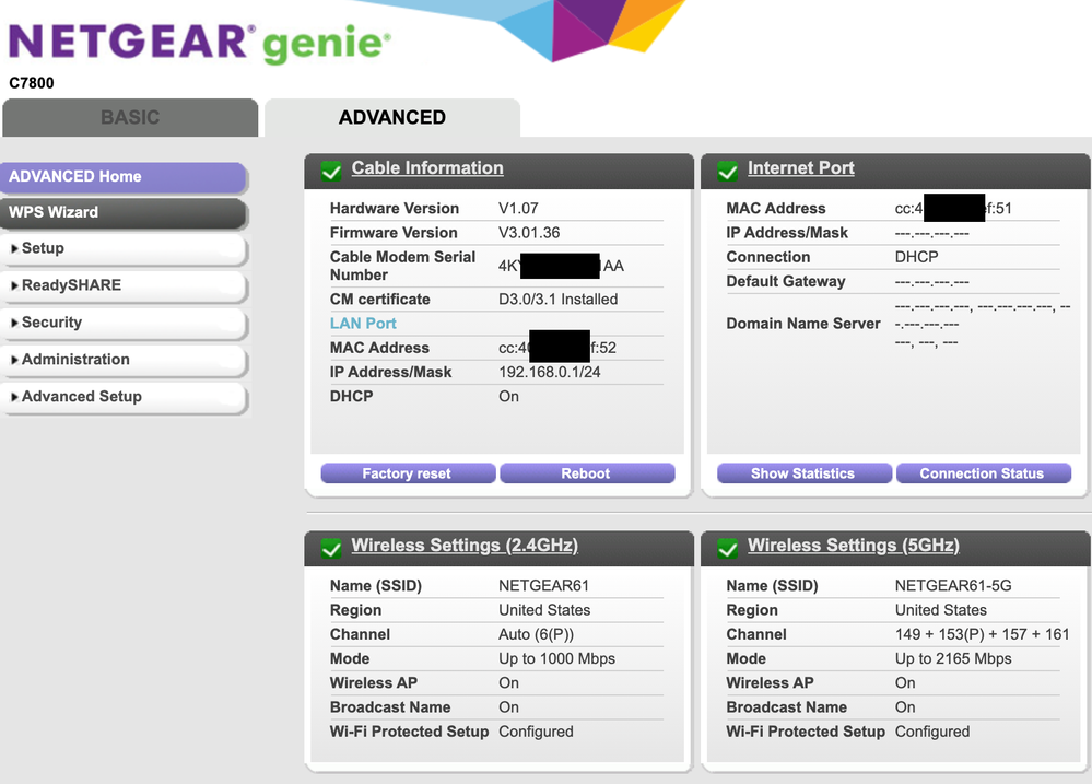

    The one one the sticker should be used, MAC and it should match the one seen on the advanced tab for the WAN side or connection side of the modem. Not the LAN side. This MAC will be different. Do you have the box that the modem came in? You can use that as well.
    Please post a copy and paste of the modems connection status page.

      Here's a screenshot of the Advanced Home tab. When I click 'Connection Status' on the right under 'Internet Port' the page contains no info just like the summary. The MAC on the sticker doesn't match either of the MAC addresses in the screenshot. There's no sticker on the box. Is it the MAC shown here under 'Cable Information' or the one under 'Internet Port' that Cox should use?
      Thanks very much for your help!
