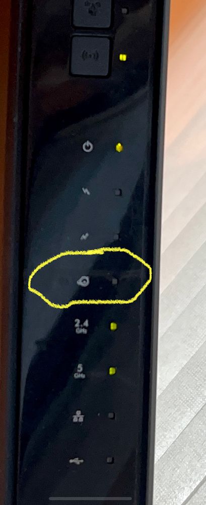

Why can I NOT find Advanced settings Netgear C6230?
Been everywhere and cannot find out why I cannot see Advanced Tab when On my Netgear page online with Netgear Page or Nighthawk. Im trying to find out why Online Internet Led light will not come on., and told I can test the lights thru Advance tab.
I have Internet service, but other devices cannot find Modem (Nest, Alexa -Echo).
I may be using wrong words, but is this my wifi is working, but internet cannot be reached?
Thank you for anyhelp.
And Yes. I have done all the reboots, connections check, etc

I have tried Chrome, Safari, IE.
No splitters
Xfinity checked and found no issues. I have my own Netgear so they sent me to Netgear.
Did all the steps you mentioned.
When I go to routerlogin.net i do see my product, but nothing that leads me to the cable connection Info. Then i get a message to confirm my email address. BUT I Do not get the confirmation email to confirm. Yikes.
- BboulderAspirant
and I have checked my spam folder. This is all too much... do you think not confirming my email address does not allow me to see the connection details?
