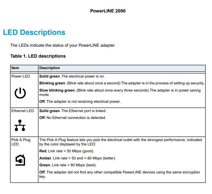

    Here the LED information of the PLA2000 devices-
    To me, the side note of an eero router made me wondering. Is this box newer in this set-up?
