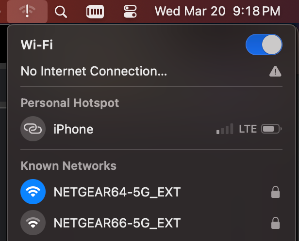

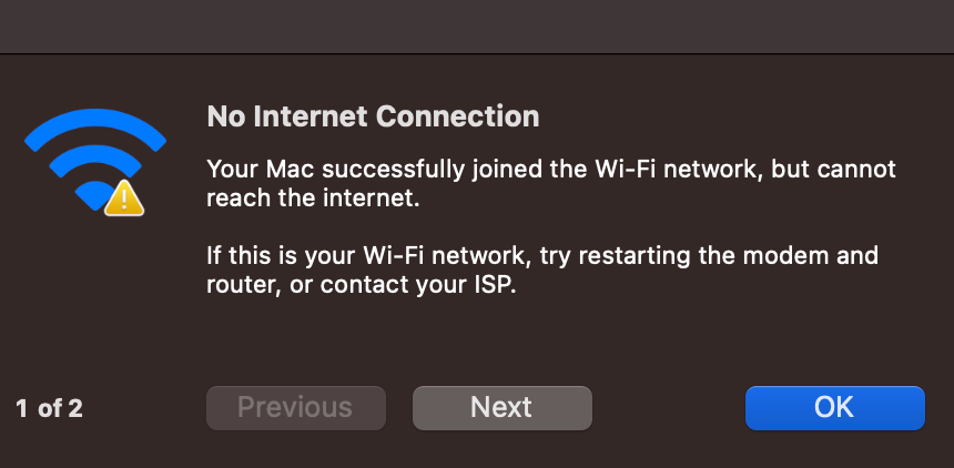

I placed the PLW1000v2 in the garage and connected it to the original system. The lights on the PLW1000v2 indicated everything is operational. However, when I connect my computer to the new PLW1000v2 (MacOS) WiFi network (NETGEAR64-5G), I get a "no internet connection." See the photos below. Neither the TV I am trying to connect nor my phone will connect to the WiFi network.
The NETGEAR66-5G, displayed below, is the other PowerLine WiFi 1000 network in the small office. My computer and other devices connect to the NETGEAR66-5G WiFi and experience no issues.

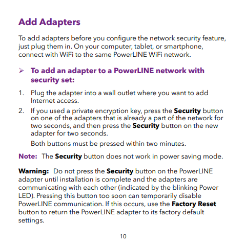

        Have configured the Powerline Key or used the process with the [Security] button from the fine manuals?
        P.10 from the Quick Start Guide might help:
