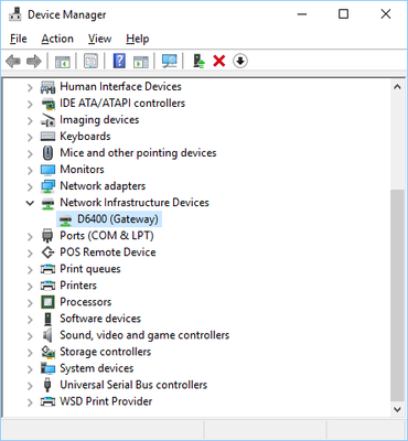

The problem is probably in Windows. Track down "Device Manager" in the Control Panel and remove any reference to the adapter in USB controllers and Network Adapters.
The picture isn't the same device, but you'll get the idea.

That didn't work. I found the adapter in Device Manager and uninstalled it, uninstalled the software, restarted the computer and then re-installed the software. Same result.
The entry in Device Manager indicated that adapter was not fully installed. One of the windows showed an error code 10. This is what the NetGear site says about the error code.
