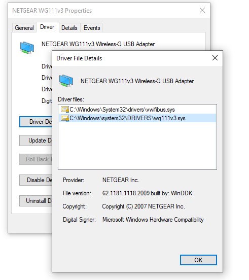

- joxs64Aspirant
I got it to work on Windows 10 as well. Not sure exactly what made it work but here is the sequence I followed.
1) Ran 2.0 installer under win 7.0 compatibility mode. Still wasn't working and it was showing up with an exclamation mark in Device manager.
2) In device manager right clicked the device, selected update driver and selected "Search automatically for drivers".
Started working. See attached screenshot of the installed drivers against the device.
