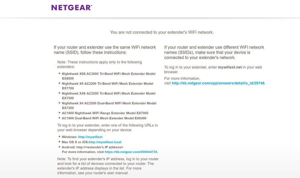

I was able to finally connect to the extender, I figured out the pw was the same as my wifi pw. But still the Mywifiext.net site tells me I'm not connected. Any ideas?
All lights (direct connect, 2G, 5G) are steady green. Extender is 6 inches from router, and I have an ethernet cable between the two of them that I know is good.

So after contacting support via chat (on Thanksgiving morning no less!), turns out that the fact that I was attempting to connect with my ethernet+WiFi desktop was the problem. If you connect to the extender on a machine that has both ethernet and WiFi, the machine may appear to be connect to WiFi, but actually be using the ethernet connection. Once I switched to my laptop, i was able to get onto the miwifiext.net site.
Are you seeing this?
Or are you seeing something else? If you seeing this, then try www.mywifiext.net, mywifiext.net, http://mywifiext, and http://mywifiext.local, and see if they work differently.
The extender has two different operating modes. One is called "extender mode", which extends your wifi network over WiFi. The other mode is called AP mode, and it is creating a separate wifi network (connecting to the rest of your network over ethernet).
You are using AP mode now - is that the mode you intend to use when the setup is complete? If it's not, then you should disconnect the cable.
