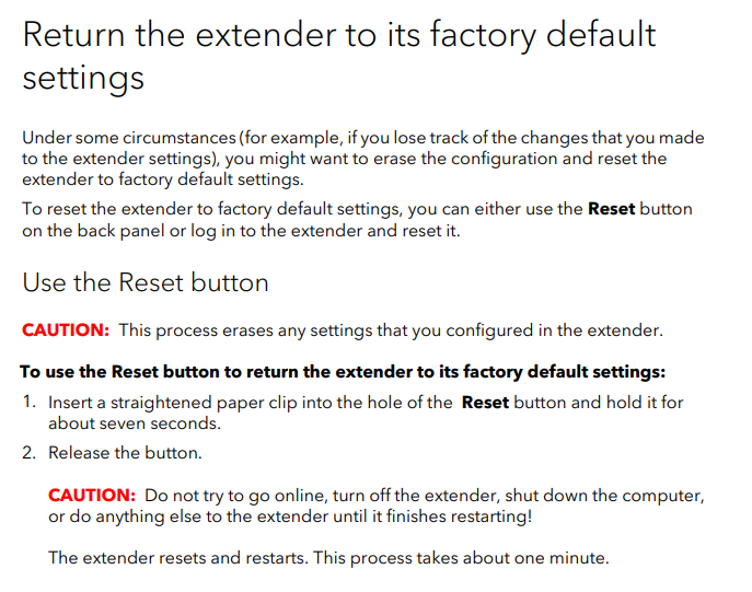

    This means using your computer or mobile associated with the factory default Wi-Fi on the EAX80.
    If your EAX80 was configured before, use the reset button as shown on p.49.
