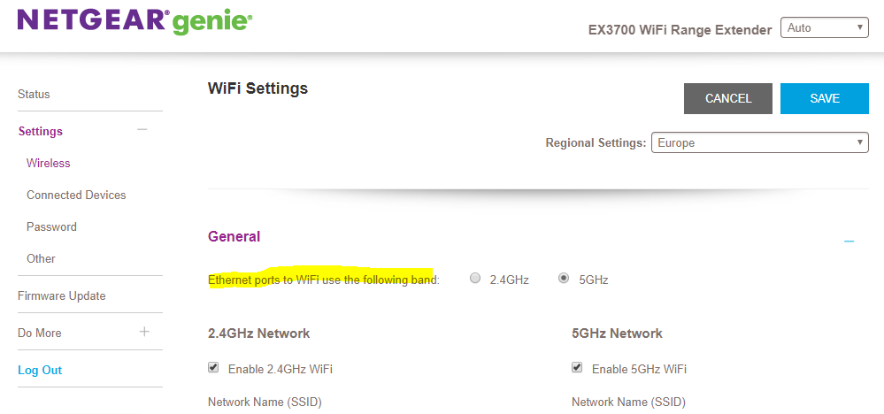

When I have it right you can define to which of the two networks (2.4 GHz or 5 GHz) te LAN port is mapped to.

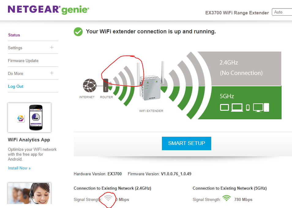

Check the extender Web UI is both bands are up connecting to the primary router.

swebs wrote:
When I connect to the extender via WiFi with my laptop I can connect and surf the internet fine. When I connect any device via the device/lan port I can't get to the internet.In either case, the LAN port will be bridged trough a WIFi connection - unless the extender does run in FastLane mode, it's configurable which uplink band is used:
Should this band not have an uplink connection - here it's the 2.4 GHz which as none (so the above does work) - the LAN port would not have a connection to the primary router and the Internet.
