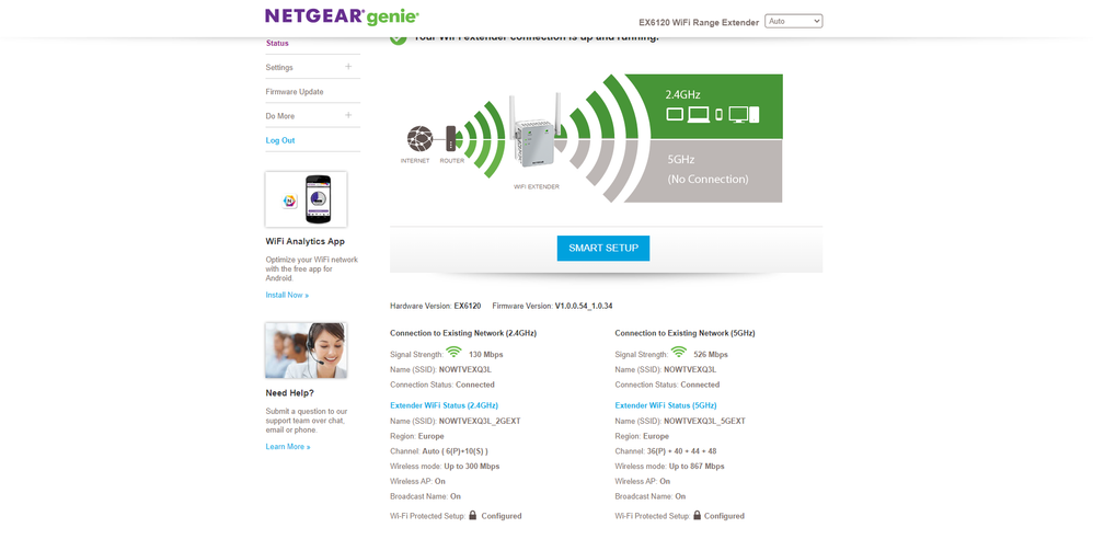

    If you log into the extender, get a screen snip of the status page. It should show us connection strengths that can help.

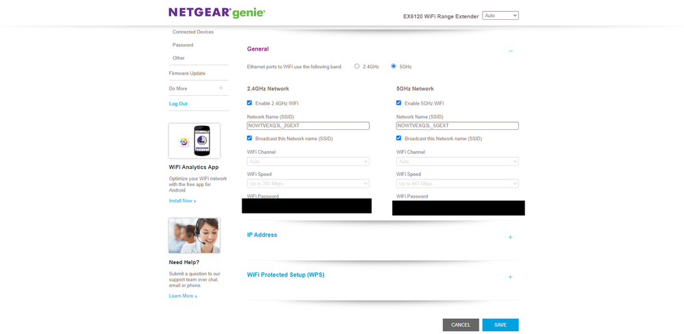

      Images attached, all the details provided are strong, does not make sense why devices are not getting consistent internet
      Please advise?

        It doesn't look like you have any devices connected to the 5ghz band. 2.4ghz is slow and sensitive to interference.
        Make sure to test over the 5ghz band
