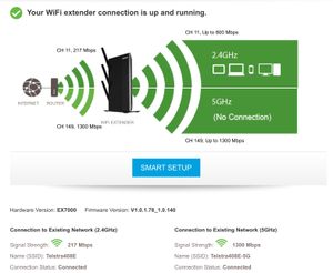

EX7000 Range Extender will not connect to the internet
I recently returned a Linksys AC1200 wifi extender because it kept dropping the wifi connections and LAN connections every 20 minutes or so for about 30 seconds before coming back up. (Worked really ...
- Oct 02, 2018
I have finally, after two days, managed to get the EX7000 to work as advertised by downgrading the firmware to the previous version. I am not sure why this would work. Why would Netgear release a new firmware without proper testing? I am assuming that the new version adds security features that are not compatible with my Netgear router.
Now to see if the connection remains stable.
Firmware version that I downgraded to: V1.0.0.66_1.0.126

I have plugged the extender directly into the router and set it up as an access point only. I can now connect to the extender wifi and see the internet. What is this telling me?
My internet connection is downstairs. My office is upstairs. I am not able to run an ethernet cable between the two areas. The idea was to have the NAS available on the wifi for both IPad use and SmartTv media streaming (which is ethernet to the router)
I can ping the extender from the router without a problem.
I just find it strange that I cannot even log in to the extender using either of the _EXT wifi names using www.mywifiext.net, www.mywifiext.local or 192.168.0.254. But I can log in going from the main wifi network to the router and then to the extender.
