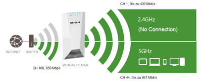

I then decided to reset the repeater and use the WPS method this time. As instructed in the manual, I performed the WPS link process twice so that the repeater connects using the 2.4GHz band as well as the 5GHz band. When I now look onto the status page, the upper part on the left of the repeater is now grey:
... which means that the link between my main router and the repeater uses the 5GHz band only, but not the 2.4GHz band. On the other side, the repeater offers both bands for clients as it did before.

      My assumption that the repeater works better with only the 5GHz band connected to the router was wrong. The 2nd info display I posted above (where the repeater is connected to the router using 5GHz only, but at the same time the repeater itself offers both bands for clients) is wrong. Actually, when the repeater is connected to the router using 5GHz only, it also only offers 5GHz band to clients. I noticed this later when I saw that only very few of my devices (those with 5GHz support) connected to the repeater.
