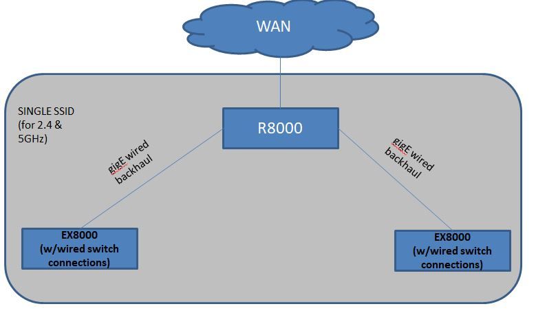

EX8000 or similar mesh extender w/wired backhaul and single SSID
I have an R8000 and would like to set up mesh extension with multiple extenders (see below) with wired backhaul.
Questions:
1) Can the R8000 be part of the mesh network also providing wifi?
2) Can all the elements providing wifi connectivity use the same SSID and handoff?
3) Can the backhaul connections be wired vs. the advertised wireless dedicated connection and not be in AP mode?
8 Replies
