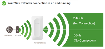

        OK it seems to indicate that it has worked this time (no password error!):
        However I checked for a firmware update and it says:
        So is it set up correctly?
