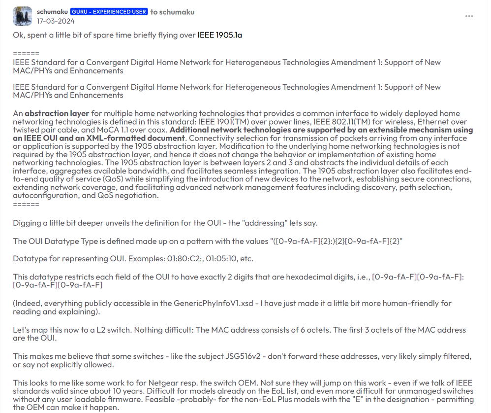

      The explanation why this often does not work is in two replies back from 2023 :
      JGS516v2 router backhaul issues | NETGEAR Communities
      The typical recent extenders like the EAX12 (and similar) are not compatible with IEEE 1905 as these don't deal with the 1905 abstraction layer. This can lead either to inop networks, or to unwanted network loop.
