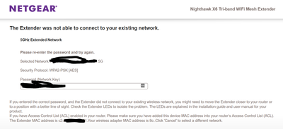

Hi, I'm having trouble extending the network created by my EAX20 using my EX7700.
This is what I'm trying to achieve:
Router Wifi ---> EAX20 ---> EX7700
(SSID1) ---> (SSID2) ---> (SSID3)
However, when trying to do the setup of the EX7700, the setup fails to connect the EAX20 5Ghz network with the message:
The Extender was not able to connect to your existing network.
See screenshot:
The connection to the 2.4Ghz seems to have been set up fine.
  • There is no ACL enabled
  • The password is correct
  • The two extenders are sitting right next to each other
  • Both extenders have the latest firmware (checked 2022-05-10).
Why is the connection failing? Is the EX7700 not able to talk to the Wifi 6 network created by the EAX20?
Any help would be much appreciated - thanks.

      Thanks for that. Good point about the triband. I'm not using "mesh" - they all have their own SSID. The loss of bandwidth and latency on the second node doesn't matter much to me since it is very low traffic.
      My current setup is now
      Router --- EX7700 --- EAX20
      and it seems to work fine. Still unsure why the EX7700 refused to connect to the EAX20 but the EAX20 can connect to the EX7700.
      I was told on the phone by netgear support that it isn't possible at all to daisy chain, which seems to be not true in this case.
      Thanks again
