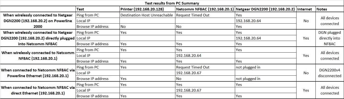

- acam6146Dec 17, 2018Aspirant
Correct. DGN2200v4 wasn't plugged in during those last tests.
I've attached a summary of the test results for assistance.
- StephenBDec 18, 2018Guru - Experienced User
Thx, the table is helpful.
The puzzle here is that the PC appears to be getting an IP address from the router (DHCP) when it is connected to the powerline ethernet. That requires two-way communication to the router through the powerline connection. But other traffic isn't flowing.
Perhaps confirm that the PC is using DHCP (and isn't set to fail over to 192.168.20.67). Then try rebooting the PC when it is connected to the powerline network. Check its IP address after the PC is booted, and see if it is still getting 192.167.20.67.
