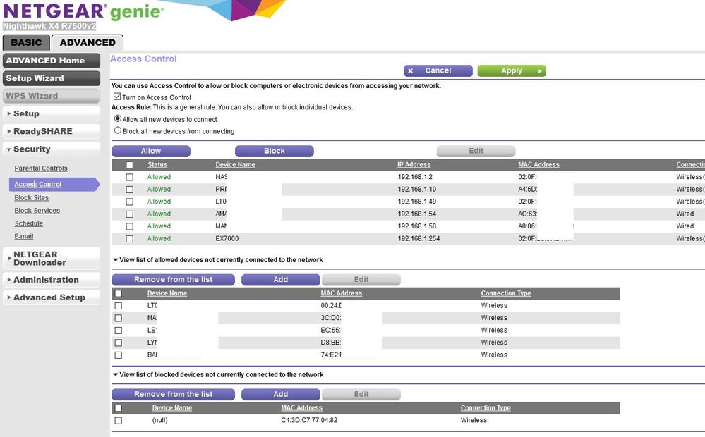

The extender shows up in Access Control just fine. All works until I configure "Block all new devices...". After applying this setting the EX7000 becomes blocked and I cannot enable the device. Hence, my extender becomes useless.
I tried editing the device but receive error: "
400 Bad Request
This server does not support the operation requested by your client."
The same issue is with a Synology NAS that is connected via the LAN port to the EX7000.
I have the latest firmware on both Netgear devices; restarted the units and even reconfigured them after Factory reset.

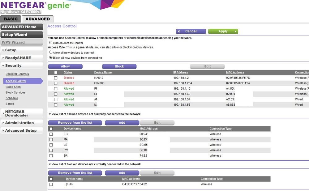

Thank you for your input. As you might be able to see from my second picture, the MAC address that was in the routers ACL was the virtual MAC of my EX7000. All virtual addresses on my extender start with 02:0F:B5.
I entered the virtual address and the physical address into the ACL list and enabled Access Control/Blocking new devices. Yes, no more "Blocked" for my EX7000.
My extender shows successful device to extender connection and all looks good. However, I cannot reach the Internet with the devices that are connected to the LAN port on the EX7000. My router does not show anything blocked. My test laptop has "Allowed" next to it in the ACL list and shows the virtual MAC. I cannot reach the Internet while Access Control/Blocking new devices is enabled. Disabling the option allows my laptop to reach the Internet.

I did see the two virtual macs (for the EX7000 and the NAS), but they were set to blocked in your screen shot.
Of course it should be working with the mac addresses set to allowed in the ACL. Perhaps DexterJB or Christian_R will have a suggestion.
