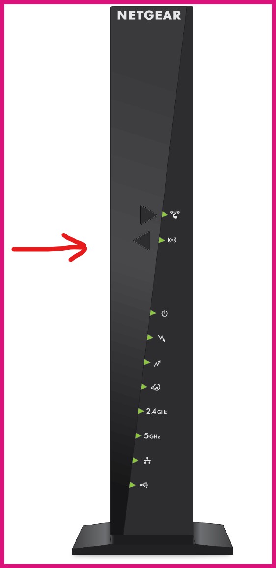

        Phil7701 wrote:
        model C6300v2
        The manual Wi-Fi on/off button is the second one down from the top.  It controls both the 2.4 and 5 GHz radios.  Toggle the on and off a couple of times to see if the 2.4 GHz radio comes back on.  See attached screen snip.
        Check both ends of your power adapter, the cord, and the receptacle it plugs in to.  Maybe try a different receptacle.
