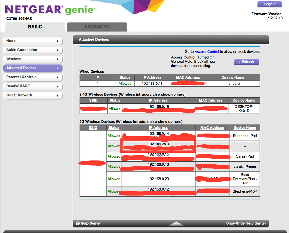

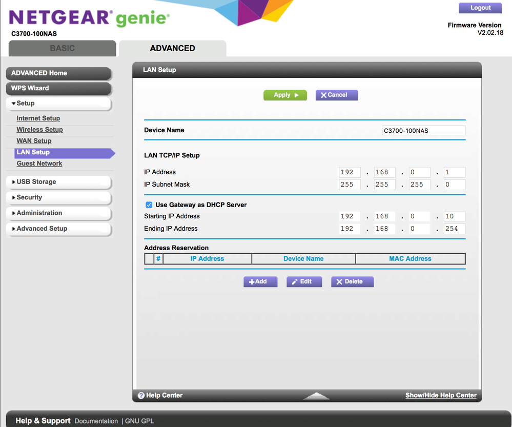

skC3700-10
Jun 13, 2018Aspirant
Yes I do see it in attached devices. See picture. No I do not have any predefined ranges, it was the default for this model of router. See picture.
attached devices screen
jg121234
Jun 14, 2018Tutor
That is so strange. I'm out of ideas on this one. As a work-around you can set the IP address on the phone to manual instead of DHCP under WIFI settings. You would need to do this for 2.4G and 5G if you connect to both.
Set the IP address to something like 192.168.0.150
Set the Gateway address to 192.168.1.1
Set the DNS address to 192.168.1.1 for the primary and 8.8.8.8 for the backup.
Obviously this is just a workaround and not a real solution to what is going on...
- skC3700-10Jun 14, 2018Aspirant
Thanks all for your ideas! I was hoping to find the root cause, but since I haven't had any luck in my searches online and you guys are out of ideas, I applied the work around to just staticly assign ip's to my devices and turn off dhcp. This appears to have done the trick as the iphones now connect with the ip's I configured and don't redirect to africa. Either way I'm getting a new router. Thanks!
